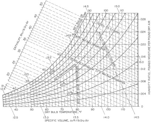

First off, Thnx to everyone. And thank you David for taking the time to offer a detailed response. your sealed box analogy makes great sense... to a point.
Simon hit the nail on the head. You see this is the trouble I'm having. I'm looking at this from a standpoint of "how wet is the air"? Perhaps that is where I'm going astray.
Looking at the Psychrometric Chart below... (rough numbers to follow). I see that at 50f and 50% RH you have .004 pounds of moisture per pounds of dry air (PM:PDA). At 110f and 50%RH you have .028 PM:PDA. A substantial increase (x7). So how does my guitar know how much moisture to suck up?
Allow me to clarify and lets put this in David's box. In the two examples above given the same RH, the actual moisture content of the enviroments are substantially different. So, again in the sealed box, what keeps our piece of spruce from being wetter in the .028 PM:PDA box than the other. It seems there would also be a PM:M3S (pounds of moisture per meter cubed of spruce) equation.
Now here I'm guessing (who am I kidding? I'm guessing through this whole thing), but is seems to me our spruce doesn't really care what the temperature is (within limits) so if you put it in a wetter enviroment it is going to take on more moisture. Like any desiccant our spruce will absorb moisture from the surrounding air and if it does not reach its saturation point it will come to equalibrium with the surrounding air. If this is true then that equalibrium point will result in a much higher moisture content for our spruce in a .028 PM:PDA inviroment than it will in a .008 PM:PDA enviroment. Higher moisture content equals swelling in our spruce. Houston we have a problem...
Now please don't take my comments as argumentative. I'm willing to be wrong here. Problem is I'm from Missouri. You need to show me.

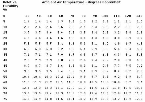

I have to agree in simple terms RH% is a good general
gauge to indicate safe conditions for wood storage.
Or where a finished instrument lives. Somewhere between
40%-50% is fine for most circumstances. Temperature has
less to do with it. As Luthiers, the real number that
matters is the moisture content of our wood.
This chart may be of some help. It shows the moisture
content of wood. It is easy to see that 100 deg. of temperature change at the same RH will only change the
moisture content of wood a little over 1%
1% of moisture content change in a 15" spruce top, can
change the width by .020 (shrink or expand)No big deal.
13% of RH change = about 1% Moisture content change.
Now lets say your building guitars and you plan to ship to some other area. We need to think about the conditions the instrument lives in. As an example the average moisture content(MC) of wood objects in the home would be around 8%. Again this is an average.

Thnx, thats a better chart than the PDF I posted a link to. Yours shows exactly what I was refering to only over a 100f spread. At 45% RH about 1.5% delta in the EMC so not much to be concerned with it seems.

One observation though. If I go into my general workshop area these January mornings, the rh is around 80-90% and the temperature is about 11°C. If I turn on the de-humidifier and leave it running I can maybe get it down to 70-80% rh. If instead I put on the heater and get the temperature up to around 20°C, the rh drops to around 45%.
So I understand that emc is responsive to rh for a given temperature, and not much responsive to temperature at a given rh. BUT if my problem is how to control the best environment to build and keep guitars, my solution here in January is to switch on the heater not switch on the de-humidifier.
rh responds pretty dramatically to temperature and the emc responds to rh, so in a way emc IS responsive to temperature when you remove the ceteris paribus of rh staying constant.
